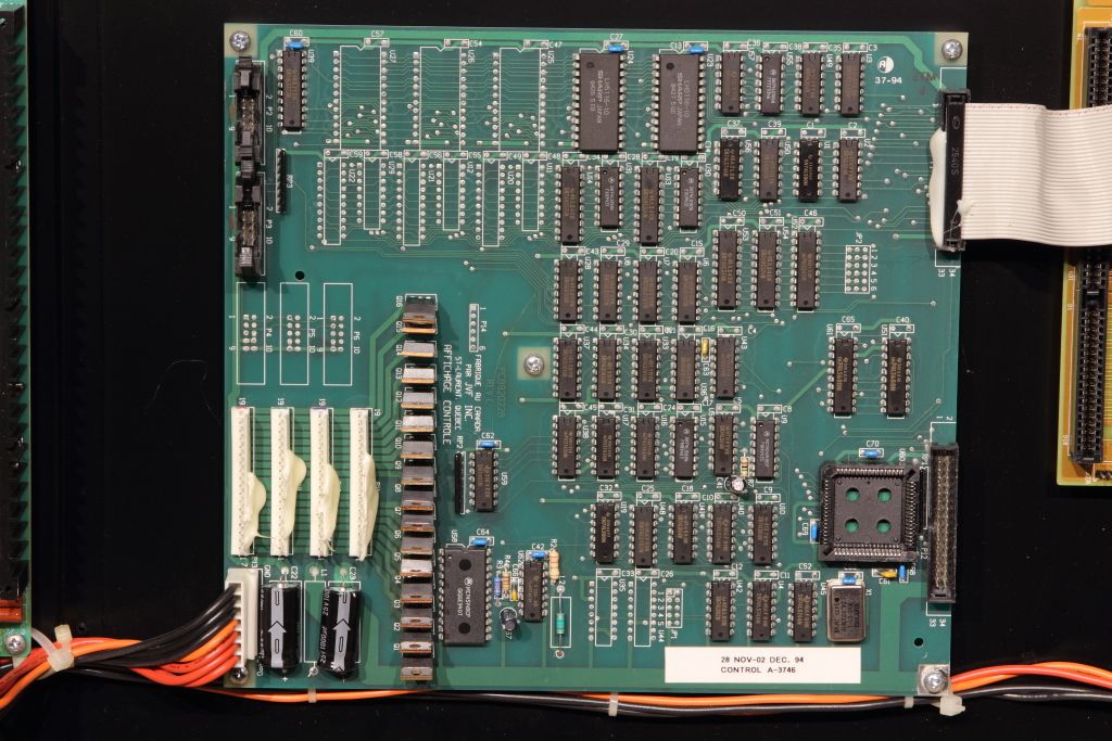

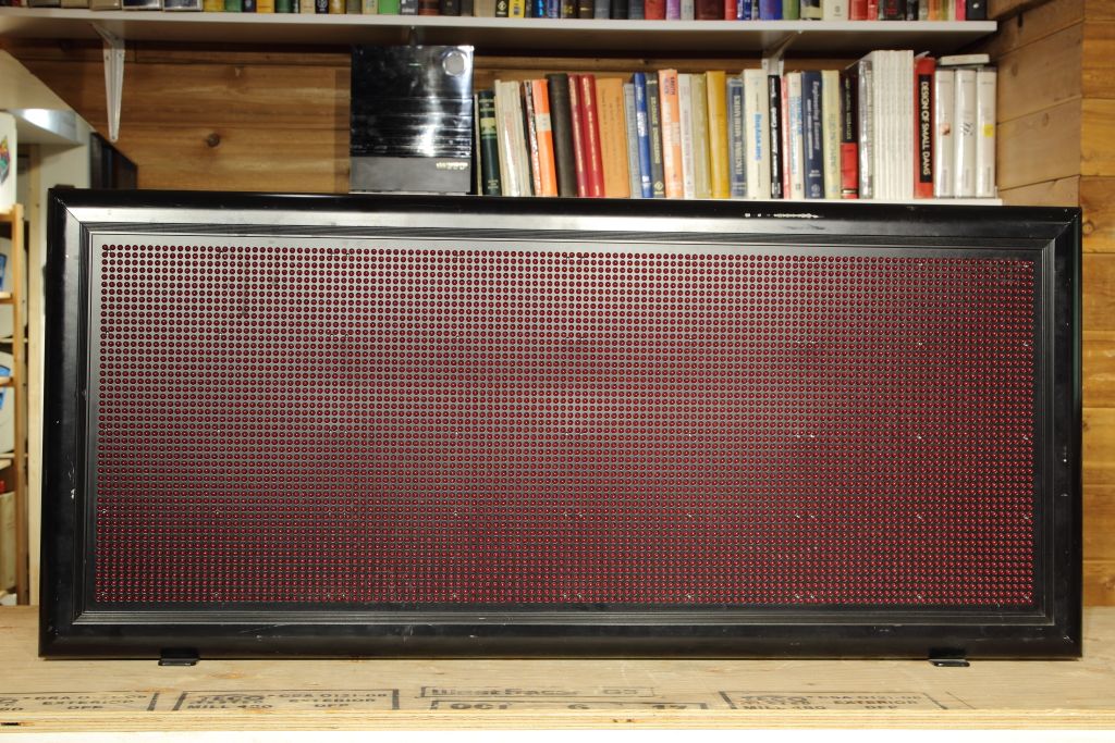

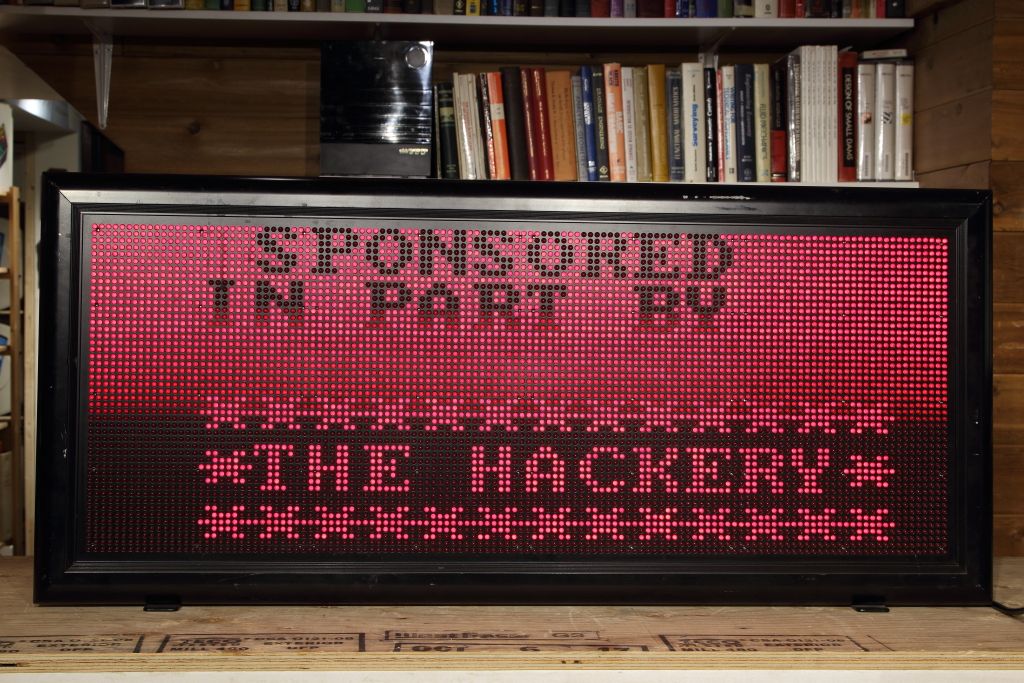

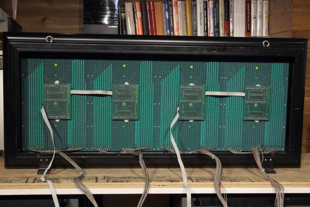

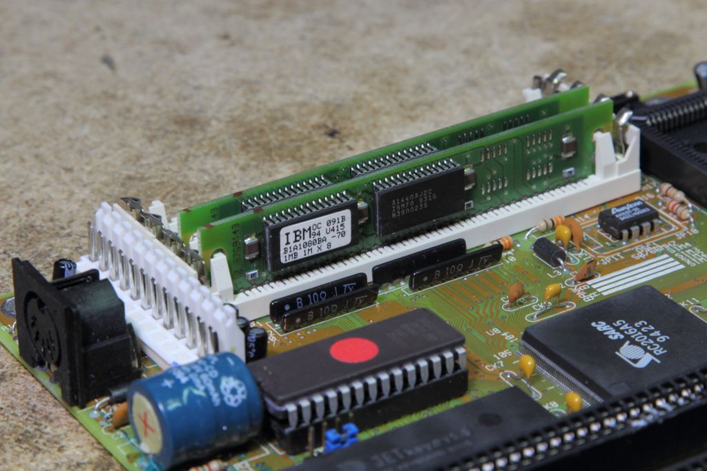

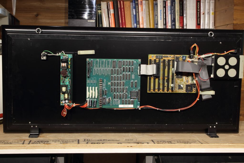

    This was a gift from The Hackery as they had to clean an area out after a water leak. It's basically a giant black upright/hanging LED sign that boots from a floppy disk.

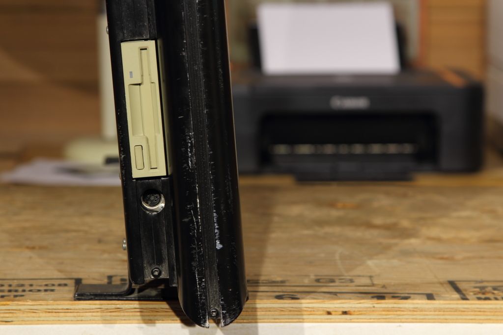

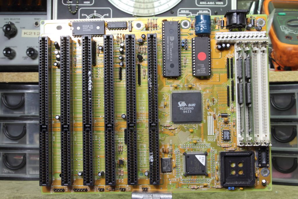

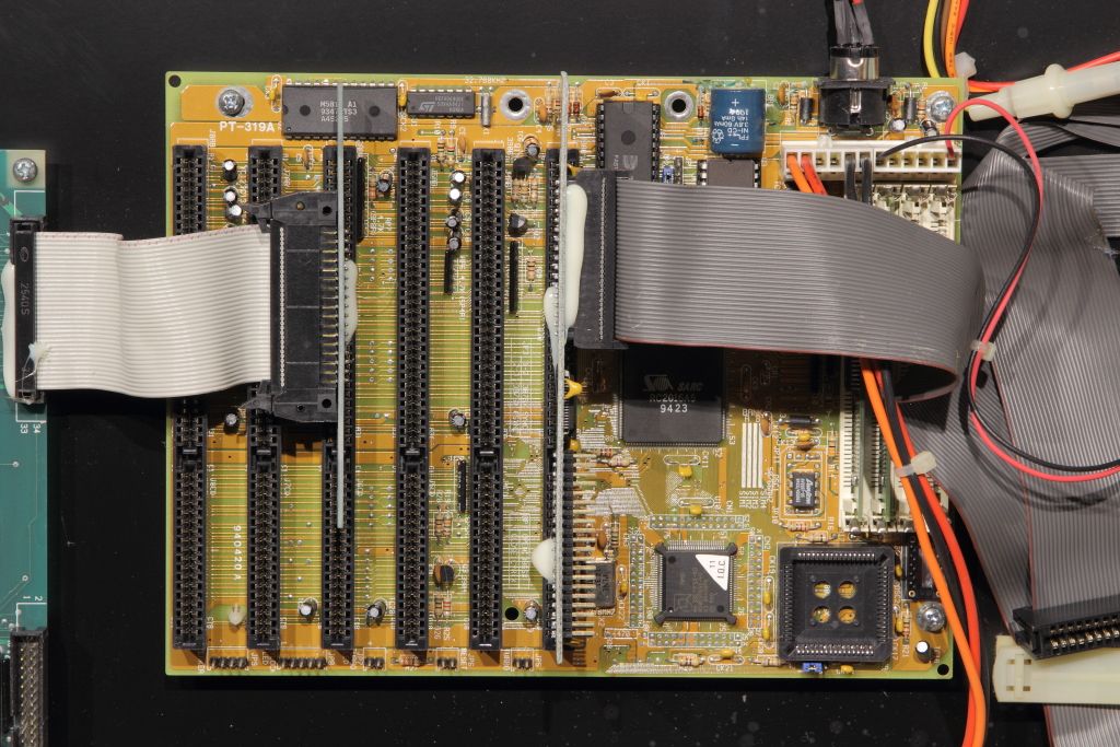

    It it seems to of been spared the water but has floppy drive issues so I had to open it up to clean that. As it turned out it's just a Baby AT 386sx-40 board with a Goldstar floppy/IDE card and a passive ISA adapter that plugs in the board that controls the LED panel itself. No video card strangely and the display controller has nothing that also resembles video circuitry, yet the system will boot fine with a flat and badly leaking battery so it's something that default values support.
    I also took the liberty to dump the floppy disk. Here's what its file structure looks like:

    It's clearly booting DOS in some manner so it's not something custom rolled to work on PC hardware. Autoexec.bat and config.sys do not seem to be that descriptive besides it just invokes the sign program.
    :\>type config.sys
    DEVICE=A:\DOS\HIMEM.SYS /TESTMEM:OFF /V
    FILES=40
    BUFFERS=20
    DEVICEHIGH=A:\DOS\RAMDRIVE.SYS 768 512 128 /E
    A:\>type autoexec.bat
    jvff circle
    Searching 2010-A from JVF gets me results for the sign but so far not much information on how exactly you create cards for it. From trial and error it seems that UTILITY.EXE converts 128x48 bitmaps into cards. That's about it but video demos indicate there's more that can be done but don't explain how to enter the other modes.
    At least I know the DIN jack is for a keyboard.
