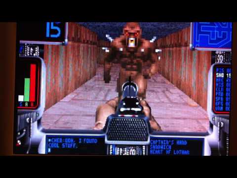

          hello - well Doom 1.9 demo runs
          ...not fast, rather slow. I did count 200 frames and it took 86 seconds, it gives 2,3 frames per second
          ...AND the keyboard did not function, but with the mouse i did wander around in the castle....

            It's not the CPU that you're fighting; it's the bus and supporting devices. After all, you have to get information to the CPU somehow and get it out somehow. Or, to quote an Irish saying: "Cuir síoda ar ghabhar agus is gabhar i gcónaí é."
              [ATTACH=CONFIG]37478[/ATTACH] [ATTACH=CONFIG]37479[/ATTACH]
              /cimonvg
              That is the most beautiful thing I have ever seen. Slow or not, it's running Doom!
